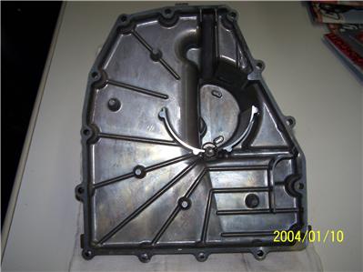

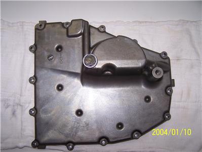

0304 636 mystery bolt thread? - old man roger - 09-21-2012 No bolt there on my bike. 0304 636 mystery bolt thread? - Nappy - 09-21-2012 Is it visibly leaking Greg? I thought you said you couldn't see anything? That's why I said probably piston rings if you're just losing it..... 0304 636 mystery bolt thread? - loogie - 09-21-2012 Idk but stuff that bitch full of JB weld and pop clutch! 0304 636 mystery bolt thread? - sikgixxer750 - 09-21-2012 check the vcg. 0304 636 mystery bolt thread? - robotjerk - 09-21-2012 i know the hole you are talking about and that hole leads to nothing. I know because i freaked out one day when i saw that hole and i thought i was also missing a bolt, but after looking at an oil pan that wasn't on the motor you can see that it leads to nothing... im very curious as to what it is for. I had some drips of oil coming off of that hole but it turned out i had a very small pinhole crack inside one of the round divits also on the bottom of the oil pan and it was coming from that and simply running to the lowest point of the pan (the mystery hole) ![]()
